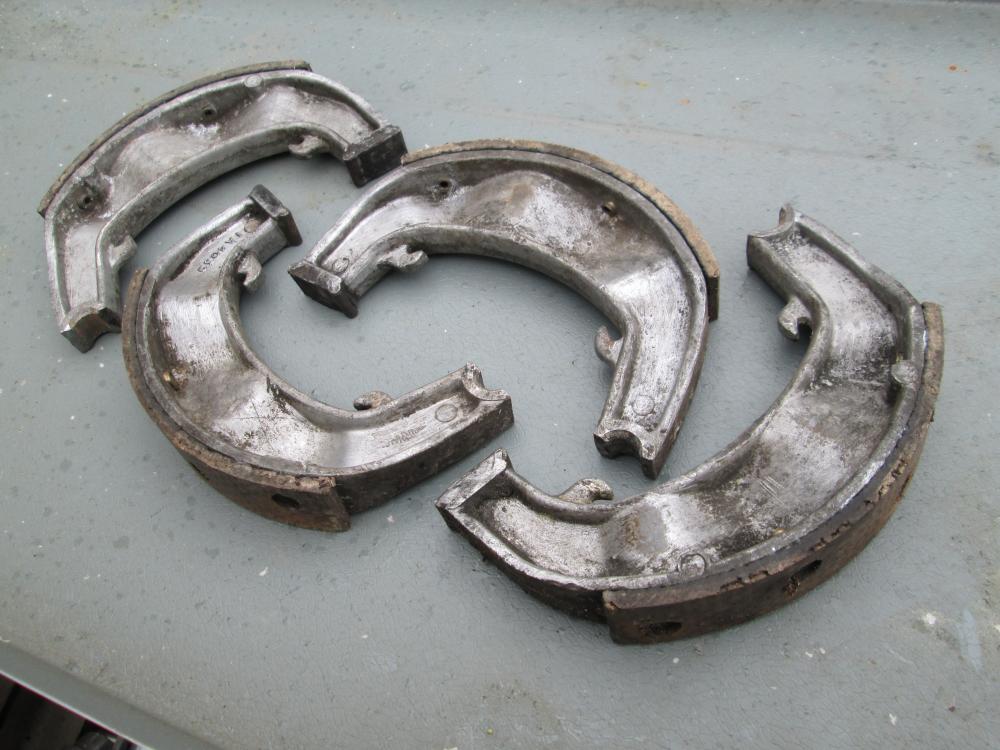

1" BRAKE SHOES and DRUMS. I've discovered that the 1933 RP that I'm rebuilding (The Thing from the Cesspit) was running with earlier 1" brakes on the front axle. The four shoes are all in good condition. I urgently need a set of four 1 1/4" shoes. Would anyone like to do a straight swap? I also have a pair of decent narrow drums available.

Dad had the same thought about the 1 inch linings Dave, and thus fitted them to the chummy. I cant tell you how they compare as I've not driven one on 1 1/4 ones!
Very interesting responses. It hadn't occurred to me that 1" shoes could be safely used in a later car.
I'd prefer to change them to 1 1/4" for the simple reason of standardising the "fleet".
The linings on these shoes, though still quite thick, haven't seen any action for the best part of seventy years, thirty of which were spent in a cesspit, so probably a good idea to replace them before the car hits the road. In any case, I have spare 1 1/4" linings on the shelf.
